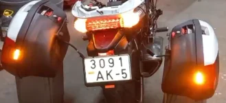

the update continues, additional lights have been installed on the turn signal and stop light on Givi
This is mine. Admore Lightning from Canada. Works perfect and easy to connect everything.
