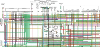

Hi all. I've just got acquired a 09 DN01 that has been parked up for a few years (lost keys) Hoping to get it back on the road in time for summer. Its a bit of a project for but I'm hoping the collective wisdom of this group can help me through it!
USA without HISS. Not PDF sorry - can post only JPG.
Here's part of the one with HISS, you should be able to compare easy enuff.Dino with HISS.webp
If desperate the pdf of HISS bike I send it as a message. I don't have pdf of USA model.
Here's part of the one with HISS, you should be able to compare easy enuff.View attachment 965
Thanks for that. The US one is still a bit blurry but I think I can make out enough to map the 2 ECU pin for pin. The main differences are in the 2nd connector where there's an additional feed (b/w) into pin 16 on the US version. There are approx 2 pins that are not used in the US version that look like they are labelled for an immobiliser.
