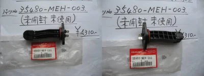

I was looking in service manual about what sensors there are used and after some thinking it seems logical for me the reason probably is the oil level sensor. This sensor is a floating type sensor and according to Service Manual it has contact points. Seems pretty possible for me those points may not working very well in age of 13 years? And the sensor is installed on bike's engine front right side corner so the float may give some faulty readings while bike is inclined to left and front up.
And after all Honda provides now an upgraded model of the floating sensor with part number 35480MEH003 (old part number is 35480MEH000).
This sensor is used only on DN-01, not on any other bike, so there seem some reason to make some changes to the sensor, et least there are quite a lot of complains about the oil warning light issue. My bike is from 2008, probably it has the first type of oil level sensor and it is time to change it anyway.
In Service manual there is a procedure described how to inspect and change the oil level sensor. It is a floating type of switch, it may be possible for it to stuck the float into unwanted position causing therefore a fault alarm:
Seems pretty easy first to change the sensor rather than pay some hours of labour for dealership for troubleshooting and after that for changing the sensor anyway.
View attachment 434 View attachment 432 View attachment 433

I will change the oil level sensor for general interest, it's not so very expencive part. I'll keep informed how the newer version will look compared to the old one. It may take some time to arrive as it's only DN-specific part and probably not much of those are in dealers warehouses.
